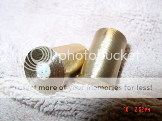

You have two choices
(1) Don't dry fire
(2) Pratice with a fireing pin stop removeing the the vibration jump .
I don't know if they make a insert for the 700 . Fireing pin .
Snap caps Or case with with a primer . Larry
