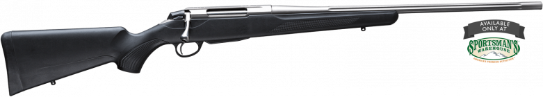

First, the Tikka website is not showing a current T3X "ultralight". Perhaps you mean the T3X "Superlite".
See: https://www.tikka.fi/en-us/rifles
I think chasing nodes via SATERLEE method (not "Scatterlee") is worse than a waste of time. As that production ultralight contour barrel heats, the POI can shift and accuracy can change. Your continued shooting won't prove anything.

Sportsman's Warehouse is showing Tikka T3X Superlilte with a fluted barrel. All the more reason you can't expect a high level of accuracy and will find that POI wanders as the barrel warms.
So, if you get 1 MOA for three shots, with a load that is safe on a very hot day, be satisfied. Go to the field and get your deer, then clean the barrel and put your Tikka back in the safe.
