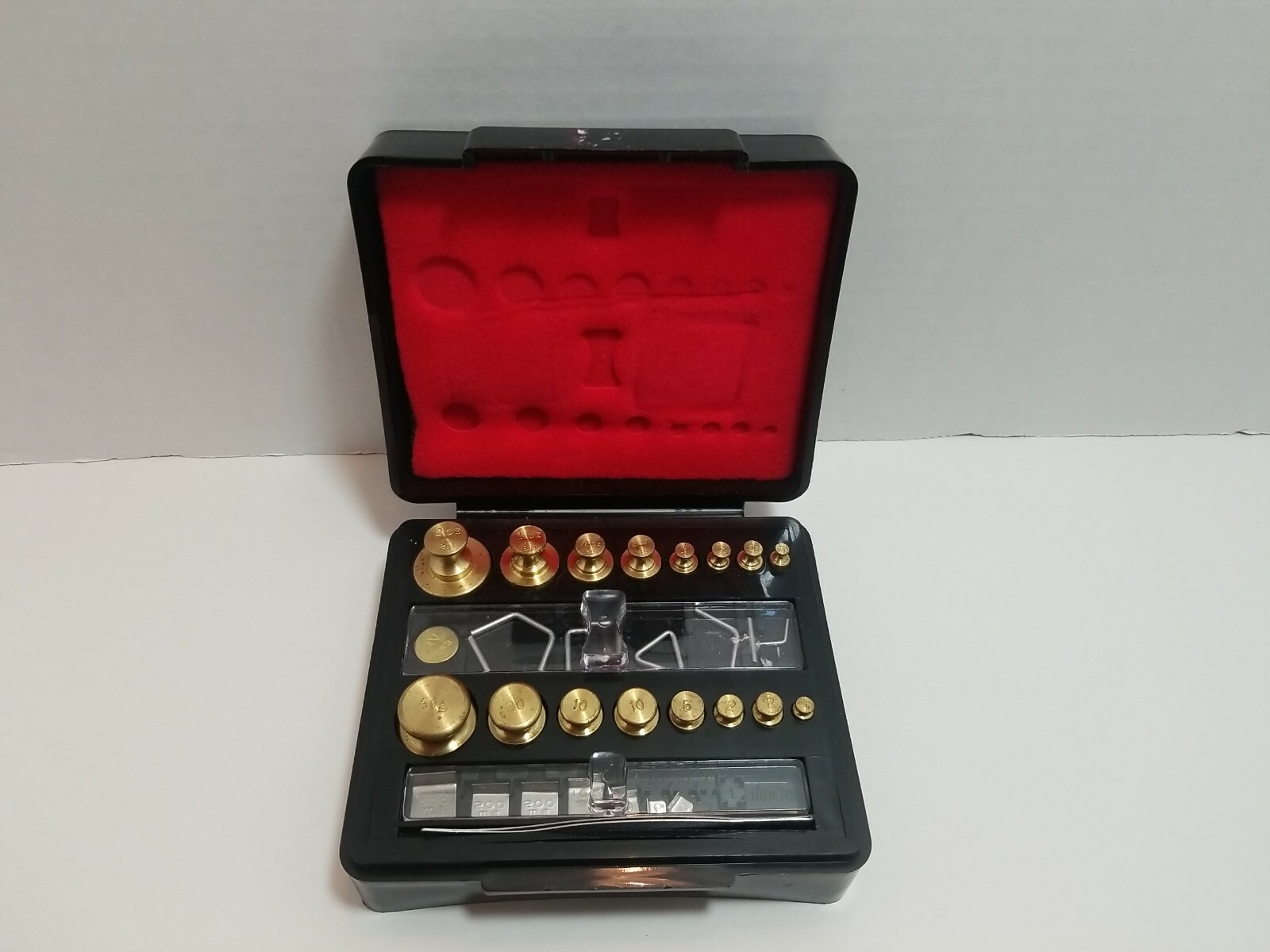

I have a couple sets of apothecary weights (they include both metric and weights in grains)and calibrate my scale within 5 grains of the exact charge I am using. A good set of Troemner weights can be found for $60
