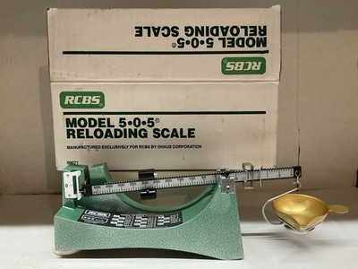

On Ebay, any of the RCBS beam scales and a RCBS trickler both used should do just fine for any beginning reloader IMO. For example:
I used an RCBS beam scale for the first 15 years or so that I reloaded - and it gets the job done - as do the other makes, all reasonably priced. Given he is on a budget, there are also a number of electronic scales that are a fraction of the good dispensing units - like the newer stand-alone electronic Hornady scale - which also works pretty well. The very best scales can get pricey though not needed.
If it were me on a budget, I'd get a second-hand balance scale as others suggested - then save up for a really good electronic scale which can be bought if he decides to stay into reloading - which some folks don't.
