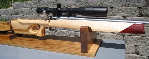

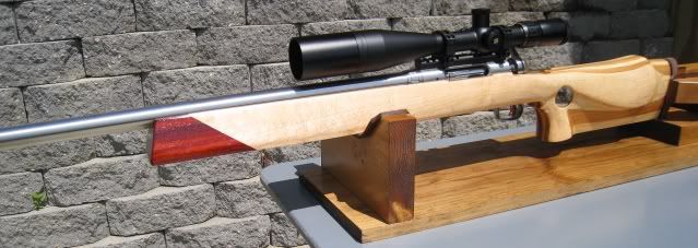

Shepheard, here is another option for you. This is a RB/LP Savage target action, barrel is a 6x47 Lapua. Stock was cut by Joel Russo. If it is wood that you want Joel should be able to accomodate with most anything you want. I glued up the blank myself on this one and sent it to him. This rides the bags real nice and I like the thumb hole.
