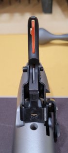

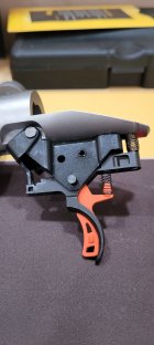

I recently bought two Savage Model 12 PTA's from James @ NSS I am unable to adjust either one of them below 2 lbs. The are the orange blades and should be able to adjust down to 6 oz. I have had these triggers in the past and had no problems with adjustment. I called Savage and the lady I talked to was of no help. I then made contact with James and told him of this problem. He agreed with me and said they should adjust down without no problem and that this was a first he had heard of anybody having this problem.
Perhaps there was a problem on the assembly line one day, and they used the wrong springs? Or, have things changed and perhaps there's an added safety feature that needs to be removed or flipped? I have searched high and low, and I am unable to find any info on this trigger. It's like it doesn't exist anymore! Am I losing it? :eek:
Pics added to help with some of your questions.

Do those PTA's have the logo on them with safety warning on the
installation of the Precision target trigger ?? If so, It my not be a
spring issue but having the wrong Accu trigger. The red blade will
denote having the target sear and spring. I would suspect you have
the Accu trigger that only adjusts down to 1.5 lbs, And someone
screwed up by installing the wrong blade. The red blade triggers
have their own target sear and spring. It's not just a spring problem,
it would also be a sear problem.

When I have the time, I will have a much closer look and see if they "have the logo on them with safety warning on the installation of the Precision target trigger". Other than that, I thought I had it made buying these PTA's. Nothing comes easy man.

Do your sears have the “dimple” on the side of the thumb lever? That dimple identifies it as a target sear. If it doesn’t then it has the wrong sear on it.
I do know that these are supposed to be custom fitted to each action to get the lower trigger pull. I would assume some filing/stoning on the sear?

I did call, they were of no help. I'm going to call again on Monday. This time asking for a supervisor. I will check the sears though before making that call.
Definitely has the target sear. Looks to me that it has the correct rear spring(standard have a larger coil and are also silver).

I’ve used the tool obviously for the rear trigger spring. Turning it counter clockwise till I get desired pull weight, or as light as I can get it without tripping.
Those directions state to use it on the trigger return spring, which sits on top of the red blade. Turning it clockwise using the tool? I have never done that and didn’t realize it mattered. Gonna mess with mine tonight just to see but don’t know how you use the adjustment tool with that spring?
