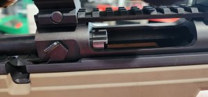

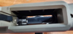

Up until now I have single feed my savage 110 in the Bravo chassis. I wanted to load some rounds that fit in a mag that I could test for trying to find an accurate mag length round. The bolt doesn't go far enough back to grab a round..... I'm not great with savages but the bolt stop prevents it from going any further back. Modification to the bolt stop would effect the bolt cocking.
Suggestions? What an I missing?

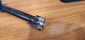

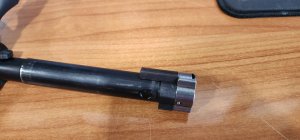

Problem has been solved. There was a 223 collar on it as shown below. Cut it down and all works fine now.
