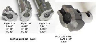

For extraction and ejection issues, try this:
Although a .140 extractor ball will usually help a lot, the other parts would be good to keep handy.
Might want to replace the firing pin if you're having ignition issues:
It'll take a little fiddling to get the protrusion correct(~.040)
They say that changing the bolt head does not change head space but on a recent 223 of mine it did--I had to re set the barrel there was about .009 diff in the two identical bolt heads
YMMV
