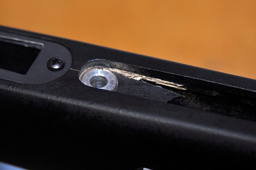

I finally got out to shoot the Savage 93R17TR and had a major problem with the bedding job I reported a few weeks ago.

It looks like you have a pillar. That should not happen if properly pillar bedded. Almost all the stress should be in the pillar not the wood. It seems the pillar was short.

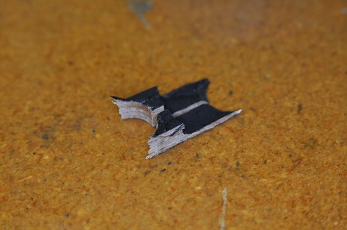

The pillar was fine, there just wasn't enough of the soft wood around it to support the weight of the barrel pulling down, thereby pulling up on the rear pillar. You can easily see how it broke the wood away and the trigger guard was the only thing holding it at that point.
The barrel has about an 1/8" space all around it, the barrel was then touching the forend.
The pillar should have been "loose in the stock while being secured to the action. The bedding holds the pillar in place with the clearence below the action. Looks like the pillar was too short and was pulled up through the stock to contact the action. Drill it out, repair the stock and do it again.
The action, front and rear should be about 1/16" above the bottom wood in the stock.
Make sure the pillar sits "above" the wood and contacts the "secured" trigger guard at the bottom before you add the bedding. We learn from our mistakes. ;)

I've pillar bedded dozens of wood stocks. Everything was perfect. Pillars met the action 100%. The action was floated "one business card" thickness from the stock. There simply was not enough wood and/or of significant strength to counteract the ability of the barrel to tilt forward and break this very little piece of wood from this area...

Stuff the broken piece back in place the best you can. Load it up with "thin" super glue. That will stiffen the area around the pillar and give it more strength. It will be stronger that the area around the hole. (Works real good on balsa wood for model airplanes. Everything will brake "except" the super glued area)
Might even consider a thin metal plate above the trigger guard between it and the bottom of the pillar?

And something else you might consider, being that it's a 22RF and you think it's the weight of the barrel causing the wood to brake out, you might think about adding a couple or pressure points at the front of the forearm to keep the weight off the rear pillar?? Just a thought. ;)
Guys, read the article before you tear him apart. The wood that broke was paper thin and soft. I thought he did a good job modifying a weak stock to shoot. I went through the same thing with a laminated Savage rimfire stock. The exception being that I drilled and tapped the rear-most boss and added a 2nd action screw under the trigger guard since there was no 3rd boss ahead of the mag well.

On the contrary, I still think he missed something. Like maybe the barrel had contact on the forearm before he pulled it apart to do the bedding job? That's why I suggested that he might consider adding pressure points up front. The wood does seem to be pretty flimsy in the area of the rear pillar. That's why I suggested maybe a thin metal plate above the trigger guard as well as some thin CA around that area to beef up the wood.
I did not intend my comments to be negative either. Just from the picture it seemed as if there was stress on the wood, and there really shouldn't be any if the pillars are the right length. Yes, if the wood was very thin and you banged down on the barrel, or squeezed the barrel against the stock, I can see how you could load that area of the stock up. Shouldn't happen from just action screw torque though.

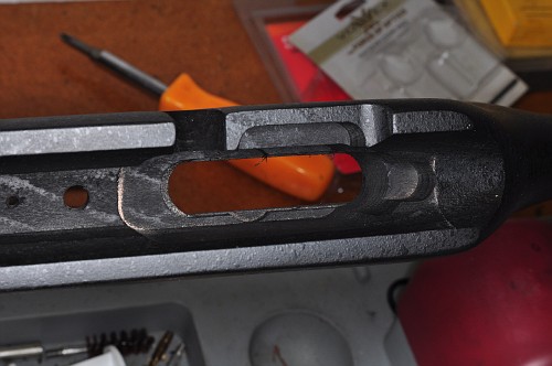

When I bedded my BTVS I had trouble with the front action screw, but not the rear. One issue is that you are taking a stock that is not very strong to start with and cutting wood out to make room for the pillar. Despite taking a lot of care I broke the wood by the front action screw and had to repair it too. See my link below on how I did it. I noted that one lesson learned was that this area should have been reinforced before drilling for the pillar.
http://www.rimfirecentral.com/forums/showthread.php?t=223949
If I was going to do this again, I would make two further changes. In the pic below where it is marked with a C just behind the rear action screw, I would dremel out a slot on each side of the stock, and epoxy in a vertical fiberglass plate. This would address the OP's issue, and also give the stock some lateral strength. It is very weak in this area.
The other change I would consider is using a different type of pillar. These fasteners are available in hardware stores and are used in furniture assembly. I think they could be used to make a less intrusive and stronger pillar to stock fit.
Just my thoughts...
