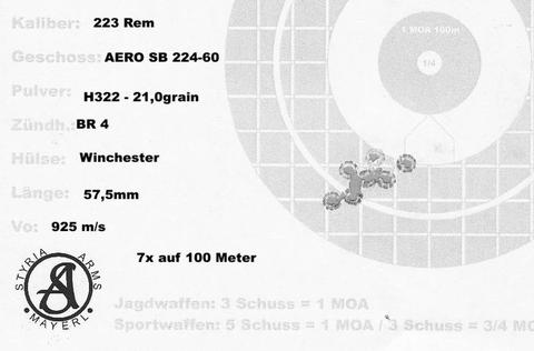

I have a 223 Rem (9" twist) - have shortened the barrel to 18" and reach about 1/2 - 1 MOA groups with 69grain Match bullets and 60grain AERO copper bullets.
