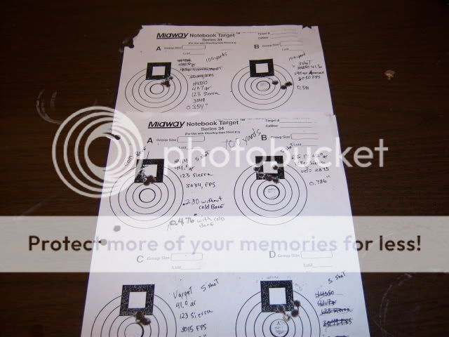

here are the kind of riflesi play with and how this one shot the fist time out with un taylored hand loads and a crappy rear bag while shooting prone!!

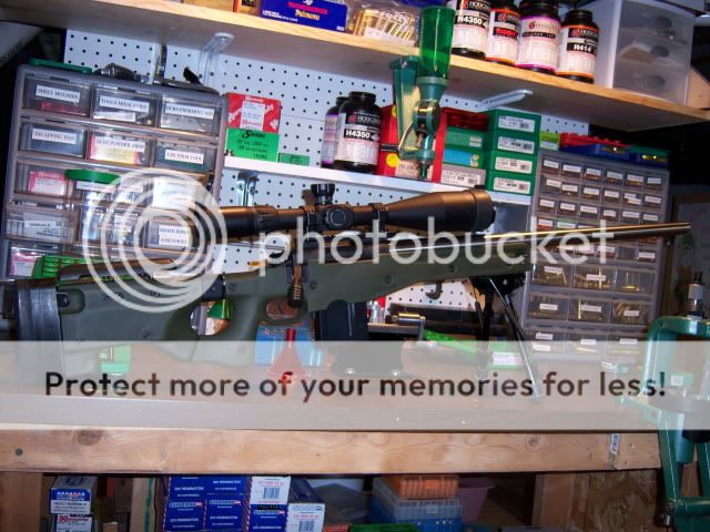

I am not,yet) a competitive shooter, but I did just recently buy a Savage 10 FCP in 308. Came with a Choate tactical stock and needed a little cleaning up to smooth things out. Put a Weaver T36 on it and my most recent range trip put 5 168 Amax rounds in a 1.25' group at 300 yds.
Accutrigger came set at 1.5 pounds. Did not like the cheek piece that came with it, so I got one from Karsten and it works great.
Still working on the load and hope to get it a little better.
Can't say how competitive this setup would be, but thought some actual numbers might help you decide. And, just for s*its and grins, here is a picture.
