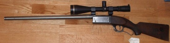

1917 Sav 99 take down.
I made another barrel in 6mmBR for it and sighted it in.
0.1" (3) shot group at 50 yards
0.3" (3) shot group at 100 yards.
With no fore end.
