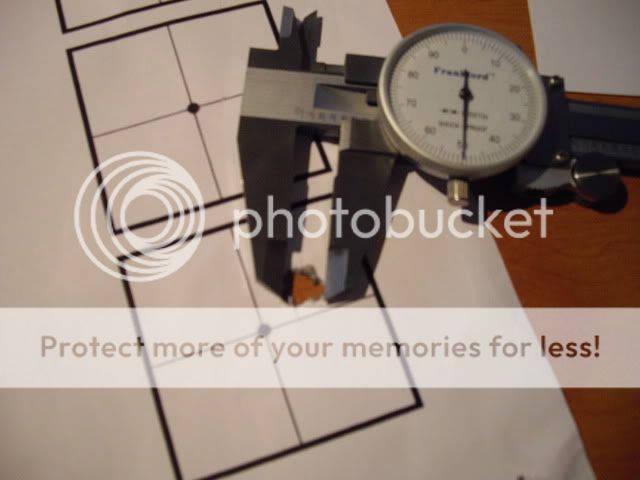

I went out and shot my new savage f class sunday. I had loaded some Lapua 105s, Lapua cases, and Rem 7.5 primers. I started at 28.5, then shot some at 29 grains, then 29.3. I couldnt even get under a half inch. The 29.3 load was already showing signs of pressure. Cratered primer and some smugging. The case overall length was 2.396. I was not shooting off a mechanical front rest or using a rear bag. Could that have made the groups so bad? ???
Yes. I'm of the opinion you did pretty well considering. What were you thinking? Spend all that money on a gun with a stock designed to ride in a front rest and rear bag, and then don't use either and wonder why your groups aren't all you hoped for?!?

If I was shooting sans rest, bag and flags (I'll assume your case) I would not expect to get 1/2 inch groups.
