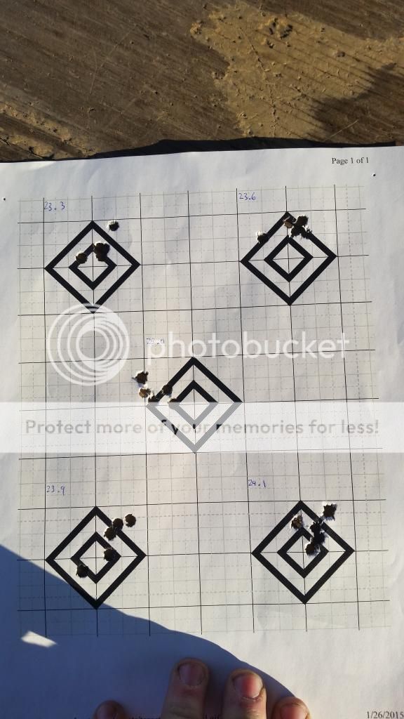

I got it back from savage and it came with 2 piece bases (I had to put my own base on originally, a one piece that I hated) and they rebuilt and put new barrel on the gun. I didn't think the scope would fit because how much shorter the bases are but it worked out pretty nicely. I grabbed some 75 gr match hornady and also made up some 68 and 75 gr hand loads. Used a few factory to get me on paper again and moved on to the hand loads. I did the OCW with 5 different loads of each bullet weight, 3 rounds each. I'm going to stick with the 75 gr and see how much better I can get it. Definitely happy with savage right now! Scope is just a Cabelas brand 8-32x50 with 30 mm tube and burris XTR rings. Leupold sun shade fit the threads which surprised me. Stock is from B&C
75 gr
68 gr - I forgot to move windage before starting so right side groups were on edge of paper/ off paper.

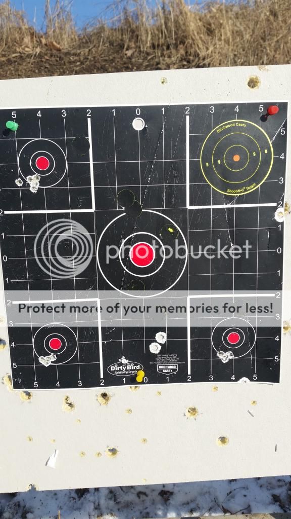

Made it up again this weekend. I narrowed down a little more, 23.9 grains of rl15 behind the 75 match bthp seemed to be the ticket. 5 shot groups this time. best was .465" on bottom right. the first 3 loads seemed to spread a little more. just me and my buddy up so we had all the benches taken up. surprisingly nice weather for once.

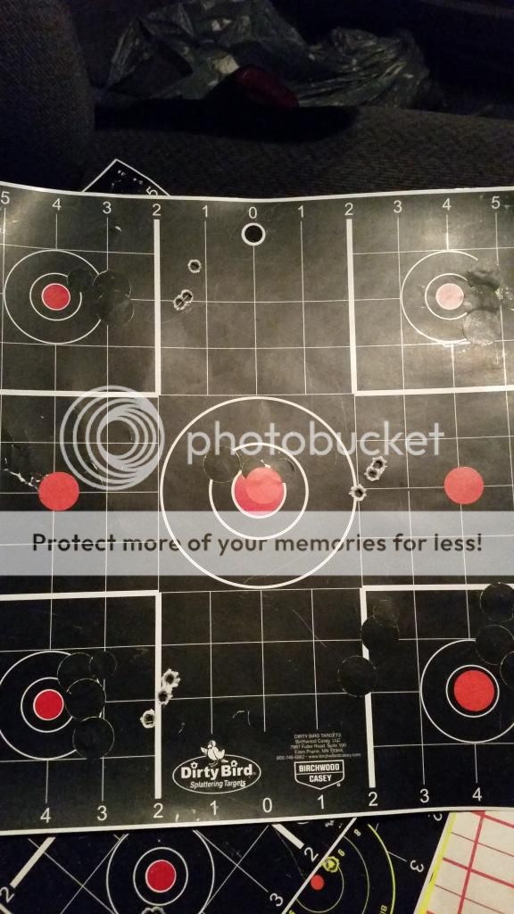

This gun is still confusing me. I set my seater to load at 2.300" and they still vary up to .010", assuming the bullet. But yesterday they left dents around the top of bullet after seating. The whole way around, where the plunger touches. And they measured 2.299-2.314". I loaded 3 sets of 5, all with 23.7 gr rl15 behind 75 gr hornady v max. I decided to try factory 69 smk from winchester out of curiousity. Didn't shoot as well but shot better than hornday 68 gr. So on my way home i grabbed some 70 gr berger vld to try out too. But anyways, when I was shooting my loads, they chambered a little harder, and when i ejected it to see why, i could see it contacting lands... which didn't happen last time I went up. Maybe that extra pressure during seating changed shape of bullet (while leaving that ring)? Neither thing ever happened on the first 75 ish bullets i loaded. So i shot 3 sets at 200 yards and ended up with this as best group. Measured .7195, damn flier. Im out of 75 grain hornady so I'll call it a wrap on that. I'll try these 70 vld, some 80 vld a buddy is bringing me and i'd like to find some 77 vld as well.

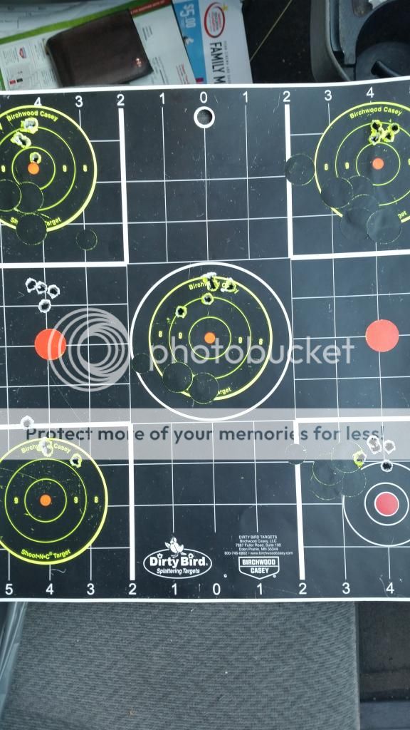

Loaded 80s touching the lands at 2.430 and the 70 vlds in lands about .014 because the short throat. Both shot well I thought for first time around. I'm getting a hold of more 80s to see if seating them .010 deeper (off lands) will change anything. Same with the vlds. Waining for the 75 vld from grafs to ship out so i can try them too.
So far it's favored the 75 hornady v max with 23.7 gr rl15 but today might have changed which bullet i go with. I'm really looking forward to those 75 vld.
Plan right now is to load more of the top 2 loads for 80 gr and more of the top right, center and bottom left of the 70s. Paper target is 80 gr and shoot n see target is 70 gr. Bottom left of the 70s, shot 1,2,3, all went in a .215" hole, 4 and 5 flew :( Too bad a I don't go by 3 shot groups. 70s were shot in a round robin. 80s were shot 1 charge at a time because i wasn't sure how far off they'd be vs the 70s
