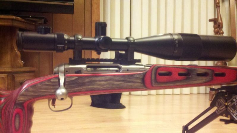

This is the Savage 308 FT/R, different stock, Talley 20 moa base, Burris extra high, NF 12-42 x 56. High would have been better.
I think the tall rings would do it.Look at how much clearance is under his nightforce to the barrel.
Yes, high or tall would be better. I will be changing. It makes the cheekpiece very high and in turn believe the added leverage of the high cheekpiece is not good on keeping the rifle "squared up" when you rest your cheek on it. Like a lever torquing the rifle to the side...

The "which height" question is what you started this thread with. See the picture of the red stocked rifle above? Those are extra highs. The difference between high and extra high is nearly 0.3". Again, you make the call.
You said you were looking for the base and the rings. Now you've got the base on hold. Folks are willing to help you but it would be nice if it wasn't a moving target.
The target only moved because the rings I decided on are out ( backordered) 2 months I have not canceled my order yet, so they are still holding the base for me. I dont want to wait that long for rings. Just doing my due diligence, so I only have to cry once. The picture above is misleading , to me. I cant even see the barrel, the stock is in the way and I have no idea how high the base sits.

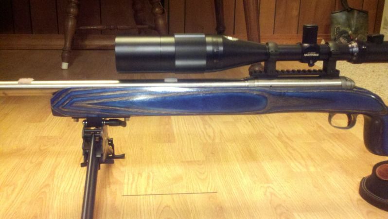

Here is another pic of same rifle, talley base, extra high burris rings.
