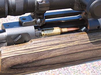

Link: http://www.6mmbr.com/gunweek036.html
You can epoxy in a plate to block the receiver well if you prefer, but this isn't really necessary. BTW, I recommend a Weaver-style rail rather than the Leupold dovetail ring base shown in the picture. At the time the rifle was built, Medium high Signature Zee rings were not yet available, so I used this set-up to get a low-profile installation for prone work.
