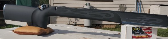

There was a question on the Roy Hunter stock thread regarding how to achieve a satin finish using a clearcoat finish. I generally shoot 3 coats, let it sit 12-24 hours, wet sand to 320, repeat 2 or 3 times to fill all the pores in the wood, then wet sand flat from 320, 400, and finally 800 grit. Then I apply Maguire’s #2 fine-cut cleaner with a worn grey Scotch-Brite pad in the direction of the grain. I then finish it in the direction of the grain with 3M microfinishing glaze on a micro fiber cloth, buffing by hand until brought to a satin finish. The following pictures show the newly cleared stock, wet sanded to 800, and then hand rubbed out. This process has worked well for me over the years. If you have any questions please feel free to ask.

Very nice but once you clearcoat it in my mind it is now a gloss finish. But, it looks good.
Yes and no...
I use a product called Vintage clear
The gloss level is directly related to mix ratios 4-1 will have more sheen than 6-1
Basically the catalyst is controlling the gloss level
6-1 mix ratio is pretty flatResized_20211027_112525.jpeg4-1 mix has a lil more sheenResized_16568647489576850653386196408832_346388361303903.jpeg
The secret/trick is to get a clean finish with no imperfections. No polishing of matt clears, the OP's method is a alternative I've been needing to play with but I'm leaning towards finish sanding directional with ultra fine finishing paper in the 3000-5000 grit range.
We use flattening paste in lacquers, if you have a product that is gloss and only rub it to satin, simply shooting it in the bags will change the sheen from contact.
I know some companies make a paste for their auto clearcoat..
Maybe Brett can shed some light on that?
