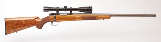

The one I came across looked more like this, at least the action/receiver. The stock is not original.
Danny
It's likely that the one you're looking at is a Model L46, or possibly an L469. Not all Model 469's are stamped 'Riihimaki', though. Both models have the toggle style safety. -Al

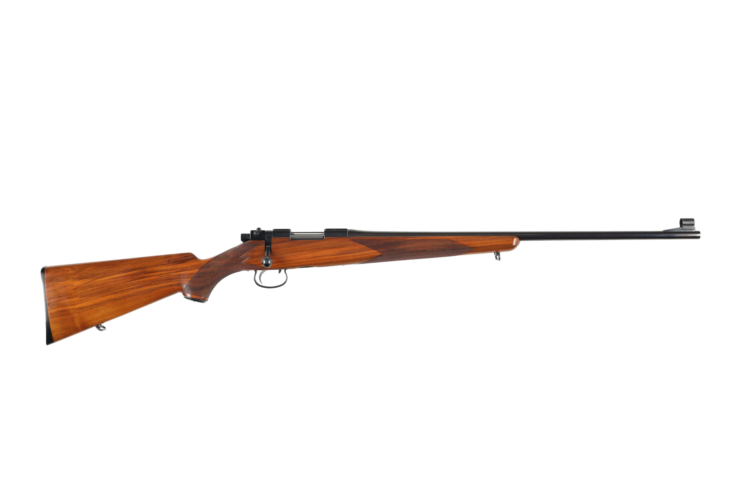

The action/receiver on the one I saw looks like this:
Danny
I have two like that, L46 Vixens in .222. One with a CanJar trigger, both with Lilja barrels. They worked astonishingly well with the 40gr VMax.35SakoL-46VixenSTU-_FLBolt.jpg
That's the correct picture of an L46 in the Griffen and Howe site. The determining feature for the L46 it has a flat piece on the bolt shroud with a rocker style safety and is box magazine fed. The pic of the one on Gunbroker is a L461. It's determining feature is the exposed or open bolt shroud and no box magazine. Later the shroud and bolt were redesigned with a red cocking indicator to satisfy US export restrictions, hence the A1. The A1 was a CNC machined receiver.
