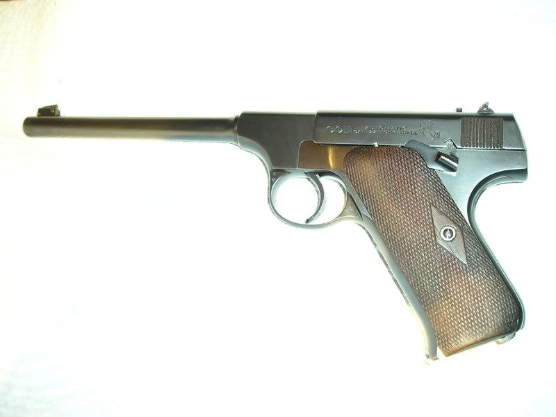

A 1920's Colt I did. Had lots of fine pitting, no original blue and been sanded a time or two by small children from the looks of it. I didn't polish the metal, just sanded up to 600 grit. If you want it to shine more buff it on a wheel before rust blueing.
Took 9 applications.

Very nicely done. 8)
