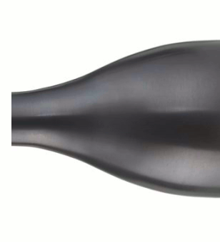

After cutting and chamfering cases, many guys find that the bullets actually slip in a bit more smoothly after the case is fired a couple times. On reason is that the angle (or lip) at the bottom of the chamfer cut blends into the case neckwall. "Rolling" the edge of the cut with a back-spin (or steel wool if you prefer), simply speeds up that blending process. For me, the difference was noticeable.
Having a smoother transition (from chamfer cut to neckwall) is one reason some tool-makers have gone to very long-nosed tools. However, in practice I have found these tools are tricky to use and can ruin your case-necks very easily.
I have talked with a couple of tool-makers about making a caliber-specific radiused chamfering tool that would provide a smooth, continuous "blend" from case-mouth to the point where full caseneck-wall thickness is reached. Hard to do with metal, but we have considered making chamferers from ceramic or some other material so the profile of the tool could have a curved neck like this:
Modified photo of a vase -- imagine a neck-entry profiling tool that looked like this -- maybe with a fine ceramic, like a polishing tool.
Now thats an interesting idea! I've got an assortment of Cratex rods cones, bullets, etc. somewhere in my shop. I think I'll do a little experimenting & see what happens. Those little curls of brass at the transition of the chamfer to the inner neck wall, using bullet style chamfer tools, have been driving me nuts for YEARS! Has anyone ever tried the Cratex? ....... Just curious.
