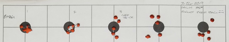

I bought a B-Mag Heavy barrel, black, synthetic #96975 in March of 2018, appeared to be older stock possibly May 2016, serial number K2514xx. I also own an older Ruger M77/22mag laminate/grey target/varmint model which is built and functions like a real rifle though the trigger with the Timney sear kit and Wolff spring is OK, my reworked B-Mag trigger is better. The B-Mag bolt ergonomics and function is horrid, the magazines are pita to load. I installed the B-Mag action in a Boyds Pro Varmint stock which required hours of fitment as the stock was cut off axis and the take down design/surface area of the B-Mag is poor at best. I also totally reworked the grip ergonomics to obtain a reasonable grip position. I bedded with Devcon, compounded the rough untouched crown, and as a last resort JB'd the bore because the bore was impossible to clean.
End result is the gun kills digger squirrels effectively with a grin inducing POP and acrobatics in the 100-200yd range.
The downside is it appears to be very heat sensitive. Here is a target shot at 100yds using American Eagle 20g, off a large/heavy front bag and hand supported rear using a 16x Vortex Diamondback HP. Shoot 5, load five, repeat. You can see as the heat builds the groups grow.
