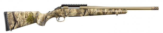

I bought a Ruger American in 6.5 CM for the grandkids to use once they get old enough to go deer hunting with us. https://ruger.com/products/americanRifleGoWild/specSheets/36924.html
I bought 200 Nosler brass for it, so I needed to fire form them and get the rifle broke in today. I had found Hornady 140gr BTHP Match bullets for a good price a few weeks ago, so I loaded them up over 40.0gr of IMR4451.

For a deer rifle at reasonable ranges, I think you're good to go - you don't need a tack driver. I would opt for the 140-grain bullet for deer hunting. A light hunting rifle does have its advantages especially in difficult terrain. But I would prefer a 22-inch barrel for better balance and depending on the powder used, more barrel length to take full advantage of powder burn time.
