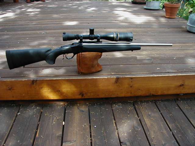

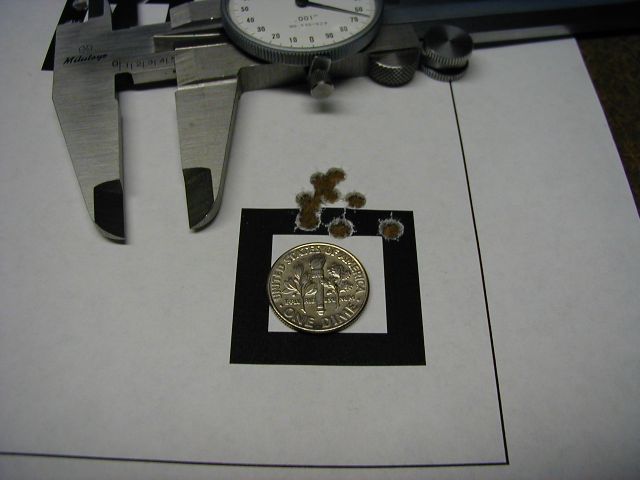

Yup, this all mirrors my own experience with No.1's and 3's. I currently field a No.1V in 223 and a No.3 in .17 Ackley Hornet. The No.1 has had all the tricks, forearm mod, Canjar single set trigger, and it will shoot in the 3's now.
The No.3 wears a B&C synthetic stock and a Pac-Nor SS super match barrel. I had to bend the finger lever and reblue it to work with the pistol grip stock. But the little rifle will shoot ten shots that can be covered with a dime using 1680 and any 20gr bullet. It's a real fun rig the size of a Ruger 10-22, but with 400 yard reach.
