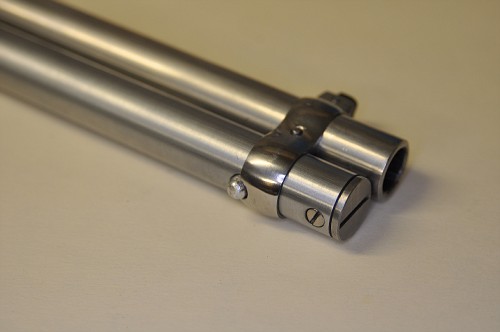

Original barrel band for a round barrel

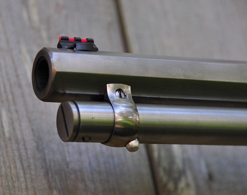

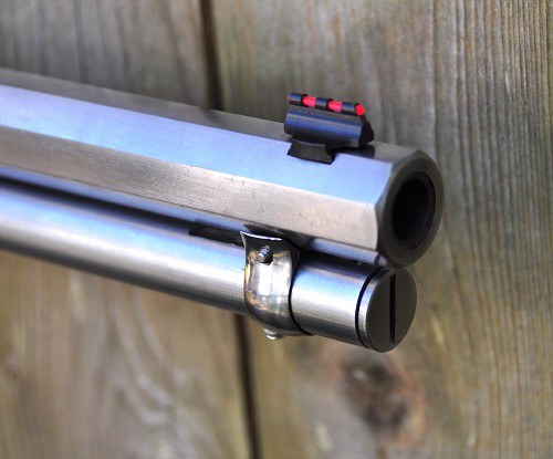

And the Octagon barrel with the modified barrel band / magazine hanger.....
(this picture makes it look like the band is away from the barrel. It is simply a reflection. The fit is tight enough that it could be silver soldered if I found it necessary)

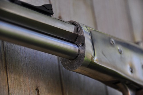

Waiting for the forend to arrive....
Once the forend is installed I'll make a decorative piece to smooth out the transition from the round hole in the take-down piece to the barrel
