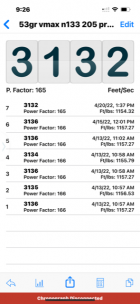

I am a rookie reloader--one caliber only my 223 Savage BVSS--Will use this rifle for casual bench rest fun and mainly as a prairie dog rifle--I am in North Carolina--Have a trip planned to SD this summer to shoot PD's. So far the rifle shoots great--I bought a couple cases of Fiocchi 50g Vmax because it was available--it does respectable MOA or less on good day--but then...I got lucky and scored a Pile of equipment from estate deal--I have everything--Redding and lee press, Reddings best powder measures, New Redding micrometer dies, Good Hornady electronic scale--brass prep items galore
So I was able to score plenty of primers local Federal 205 and CCI small rifle--Bluecollar Reloading is near me so got powder and bullets--Second time testing I hit on a combo with VV N133, 53 gr Vmax at 23.3 grains--It shot a string with 4 ES! I was stunned--just under 1/2 inch groups at 100--I switched to another brass that I had more of and back to 3/4 inch--I can get the load pretty close but can't seem to get that low ES again--I hover around 20-30 but groups are all decent just not that magic I had at first.

So you shot a string and got a e/s spread of 4fps?.. did you repeat that multiple times?… how many shot string was it?…was the chronograph readings the same with both brands of brass?… I’m betting not and if not try adjusting powder to get the same speed as your good load was

THANKS guys this is what I need--That string was LUCKY and I have not been able to repeat it--it was same brass--I swapped to brass that I had plenty of and started chasing everything again
