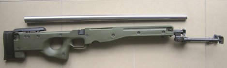

40X Guy I like the Krieger product super accurate barrels. I have a 308 win build going at the moment with an AI stock Krieger heavy varmint that im going to cut to 20” surgeon action Jewell varmint trigger but still waiting on delivery.
Yep defiantly keep you guys up to date on the progress of load testing for the 220 AI,

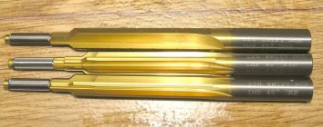

I am sort of committed to this cartridge now, as I ended up purchasing the reamers for it
