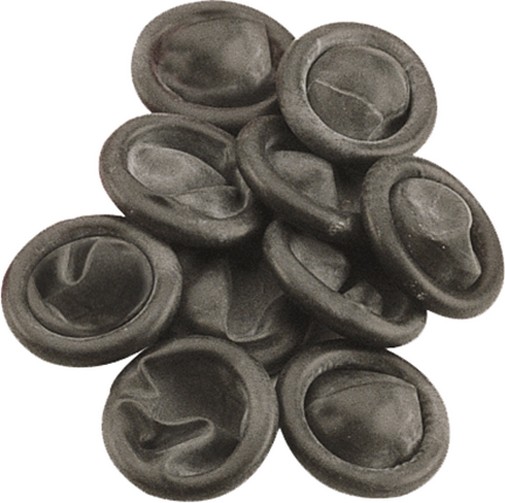

I run electrical tape over the muzzle (1 layer at the bore). I also found some muzzleloading condoms that work as well but you need to tape them on.

Been putting balloons over the muzzle for over 30 years. Tested it on one of my bench guns when I started. Doesn't affect either point of impact or group size, just blows off the end.

I use finger cots or rubber glove finger cut offs over the muzzle during shitty weather.
