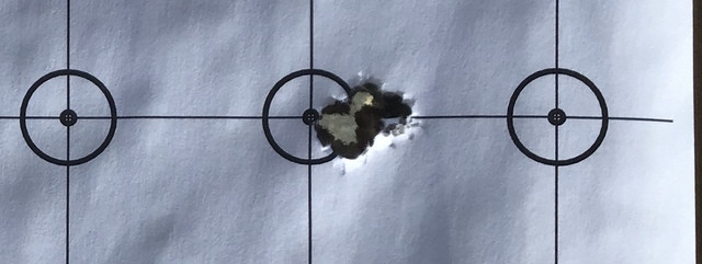

I'd keep it simple and get a R700 VLS, in .308, unless you got lucky and found one in 7mm-08. The latter were made only for a couple of years in the '90's and are hard to find. Will leave you some money for a scope.
I have, with good load development, been able to get mine to usually shoot .5 moa. Here is the last 5-shot group shot with my 7-08 at 100 yds:
