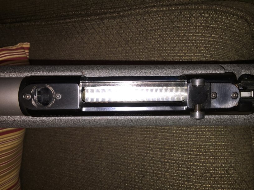

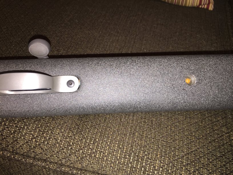

Any insight would be helpful, here are a few pics:

those pictures do nothing to tell us anything. Most likely I would guess that it has a fixed floor plate in it, probably silver in color. post pics of the inside of the action where the bullet sits before a round gets chambered... and yes new stock/ get inleted for new bottom metal that would accept a mag, or how ever you would want to do it...
You are correct in your assumptions. Pull the action out of the stock and you will be able to tell if it is glued (most likely epoxy which can be melted with a heat gun set to low) or welded. Still possible to pull the plate but wouldn't it be easier to sell it as a prone rifle as is (since that is what you have). If it has a 30" barrel in .308 it is a Palma rifle. If other caliber it is a long range match rifle. Could be sold here or:

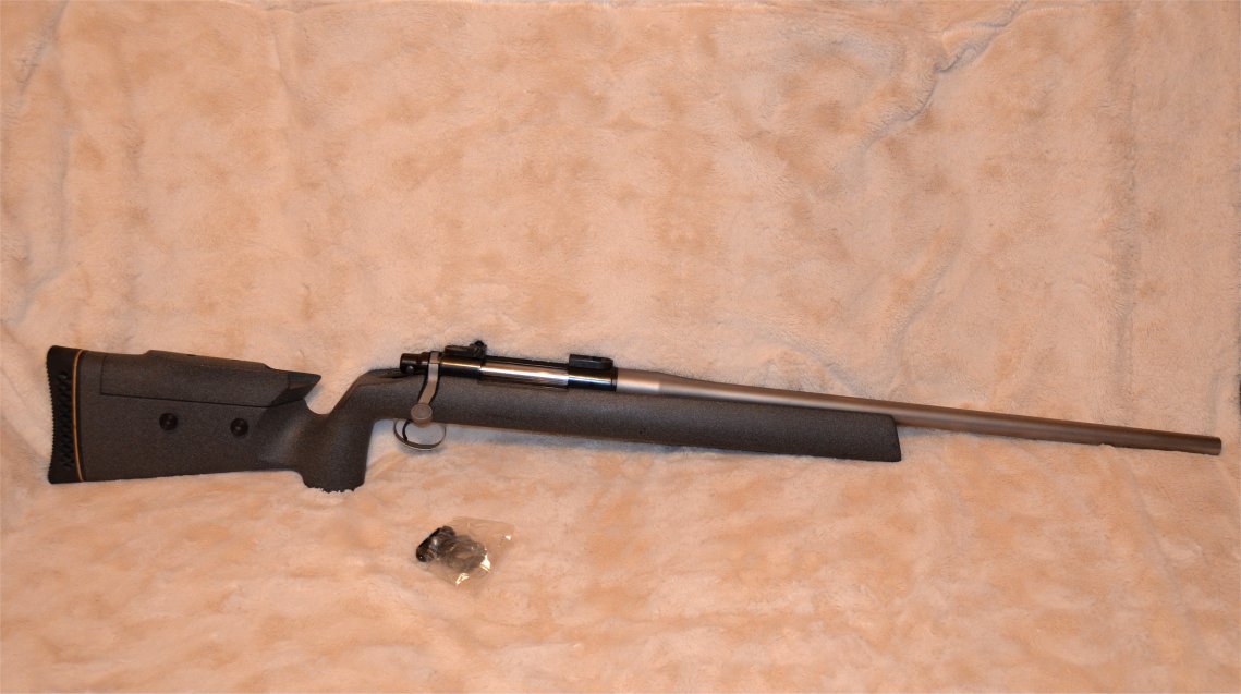

Thats no F class stock, not sure if it's even McMillan. Looks as though it could have a V block under the action would would make it virtually pointless trying to convert it, might even make it more attractive to some.
