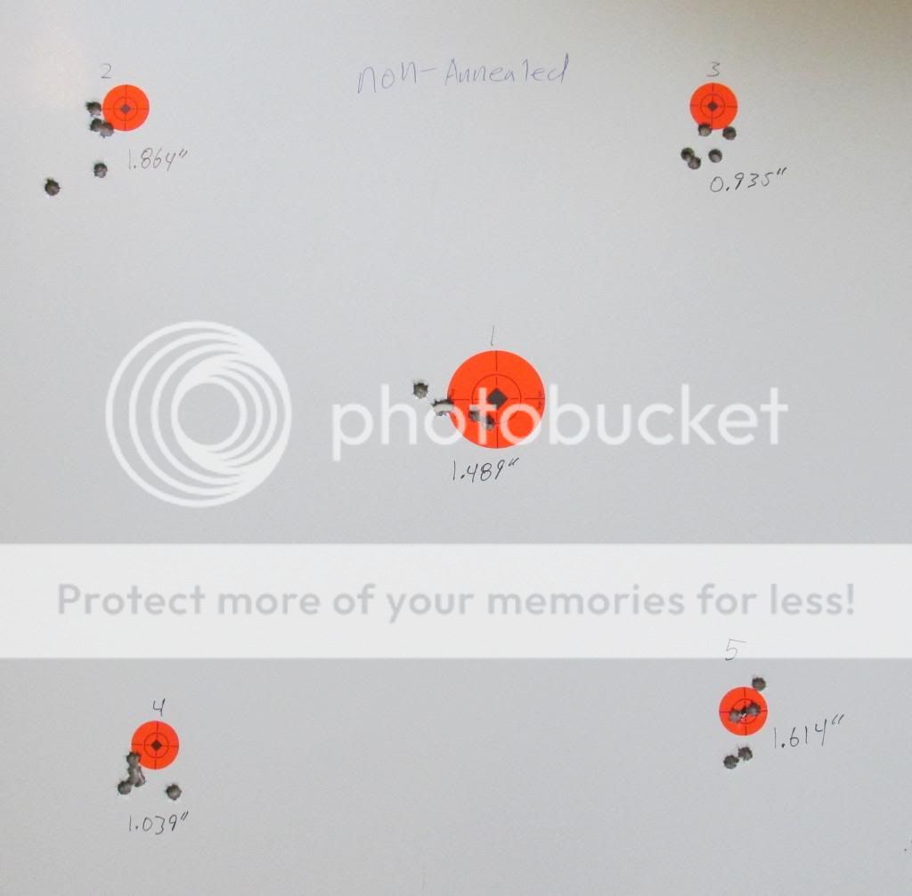

Group sizes are as follows for un-annealed set:
Group 1: 1.489"
Group 2: 1.864"
Group 3: 0.935"
Group 4: 1.039"
Group 5: 1.614"
Average group size: 1.3882"
Max/Min Spread: 0.929"
Total 10-group average: 1.3232"
My annealed groups seem to be more consistent than the un-annealed groups and I like the max/min spread difference. I think I'm going to try annealing my brass between reloadings for a while to see what happens. After today's trip, the cases have been fired 5 times but maybe only half that with the gas on. I'm going to run these a few more times with the gas off and see what happens.
