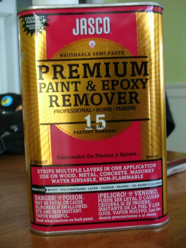

I use this stuff, found it works the best on that 70's era Remington crap coating...
Water neutralized (just use a sponge and bucket, no soaking) and safe around metals. Does affect plastics though.
