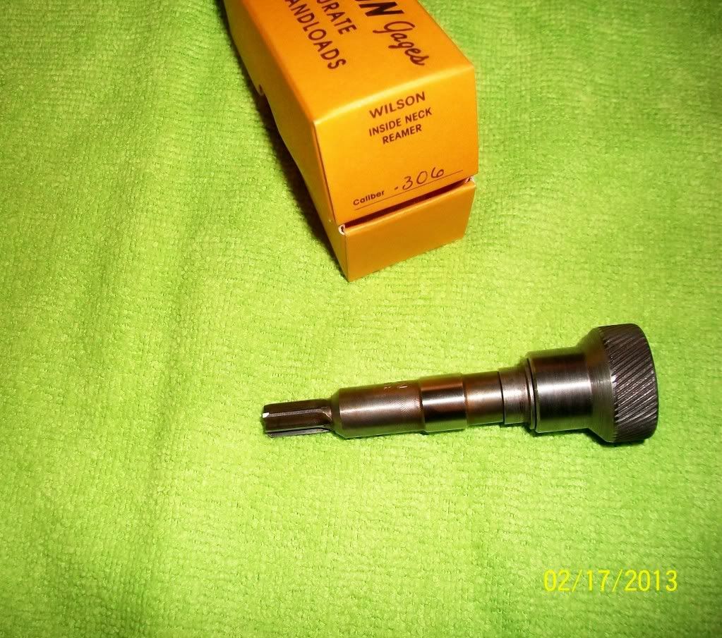

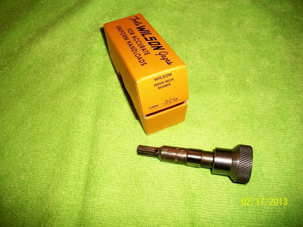

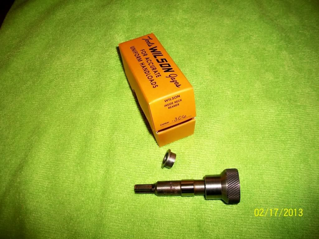

With that out of the way, my experience is that the best way to deal with donuts is when the case is in the fired form. The neck o.d. is as perfect and straight as it will ever be...and any donut will be inside the case neck. The trick is to remove as much of the donut as feasable while not in any way touching the inside of the neck that doesn't exhibit any part of the donut. If you do, the neck i.d. on the 'z' axis' will not be parallel with the neck o.d. on the long (z) axis. This will cause accuracy grief that is very hard to track down.
As mentioned by others, a chucking reamer can be useful as well as K&M's cutter mandrel. My own approach is to use Wilson cutters ground to specific dimensions. The 'off the shelf' Wilson reamers will run about .003 over bullet diameter.
These pics may illustrate my process a bit better:
I made up this flanged bushing to 'extend' the reamer and offer better support through the guide:
Bushing installed and ready to ream:
Set up properly, you can use a cutter within .001 of the case neck i.d., cut the donut and never so much as disturb the powder resiue in the neck.
Lots of ways to skin a cat..this one works for me (and other competitors whose cases I maintain).
