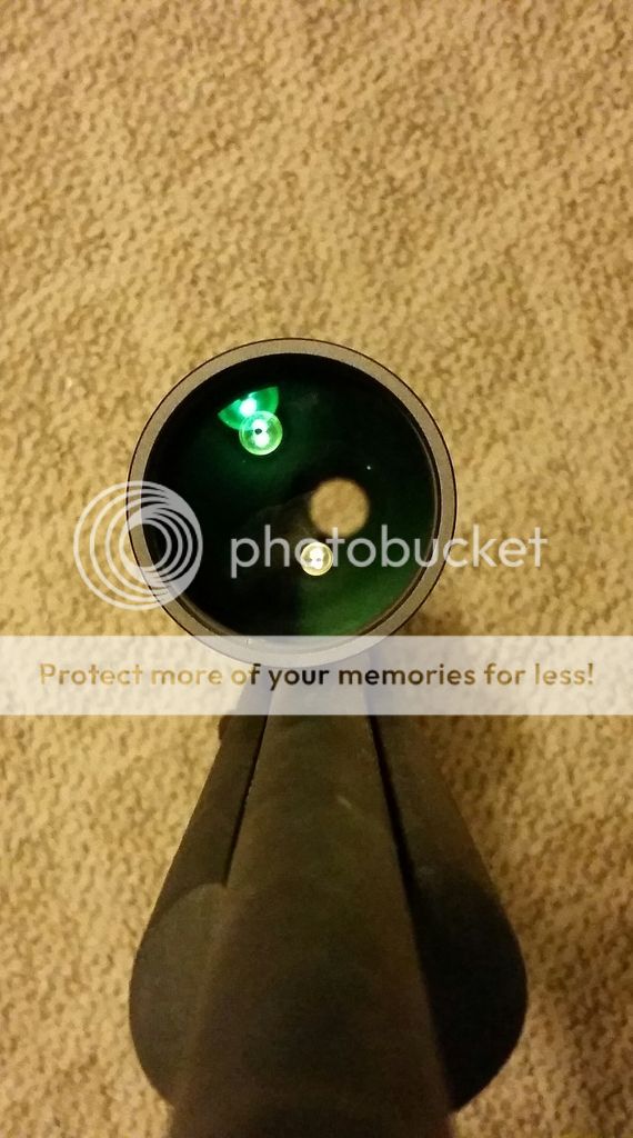

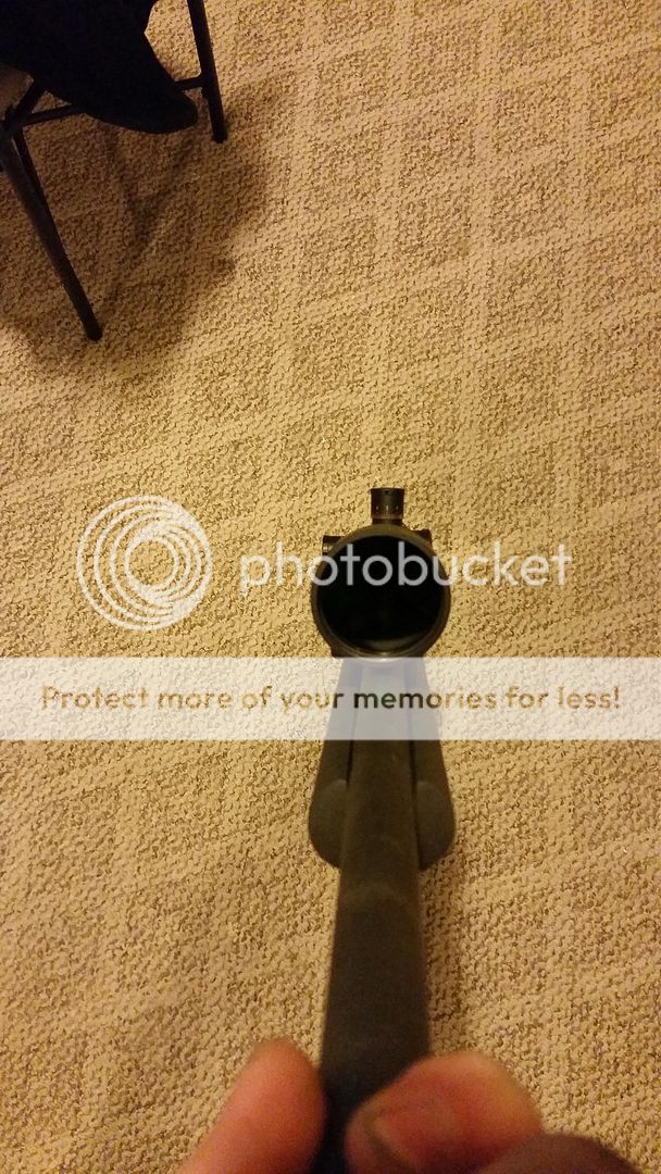

I sent my 700 police back after it shot dead center after moving windage ALL the way left. So I tried new rings, same thing. First rings, new base, same thing. New rings and second base, same thing. Had the scope checked out by sightron and they said it's all good. So Remington gave me the info to send back. I got it today, about 11 weeks later (not complaining), and first thing i see is same serial number. I immediately think well this won't go well. Mounted the scope, 2 piece burris with vortex rings. Pull the bolt and pick something to look at, a lamp about 100 yards out. Look at the scope (all zeroed) and its WAY right... just like it was before i sent it back. I'll shoot it for giggles sunday night, but I'm confident it's still wrong AND they didn't fire it with a scope on it. Notes say nothing other than it grouped. And they sent me a 3 shot group. Giving them the benefit of the doubt, I took the scope off and put a scope I know is good on, lined up, same thing. Am I missing something here or is remington dropping the ball?

I'll call them and ask if they shot it with a scope before I take it to my smith. Am I seeing what I think?
