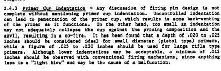

The is a minimum amount of indent in a primer to set it off, i have it some where. Velocity may be more important.

I have never had a problem with one that is too long, or maybe never knew if any were too long. However a short protrusion will not reliably set off primers. I had a gunsmith build a rifle that had a stock Remington bolt replaced with a PGT and the gunsmith used the guts out of the Remington bolt and never checked the pin depth. It would shot perfect for 2 or 3 shots then it would be all over the paper, I fooled with it for over a year. One day at Manatee i decided to not look down the scope and watch what was happening. First shot looked good the second I could actually see the firing pin fall and stop before the gun went off. After Gretan fixed the bolt, I bore scoped it and saw that it has fire cracking 8 inches down the barrel. I did a search on hang fire and found that they produce way more pressure than a normal shot. My brand new Broughton barrel was toast. A different smith chambered 2 Bartleins and it shoots good now, and there is a brand new Bartlein waiting in the safe.
FYI, this may have changed for some newer models but with that exception, Savage firing pins are adjustable for protrusion. Years back I had this discussion with Bob Greenleaf, who retired after a 25 year career with Savage as an engineer. He told me that he set his personal rifles for .035 which I took note of but did not implement, given that I did not seem to have any ignition problems. On the discussion of primer dents, for those that are unaware, it is the primer that stops the firing pin when actually firing, not the shoulder on the pin, which is the case for dry firing. If you have excess protrusion the actual effective FP fall is reduced as well as the energy.
