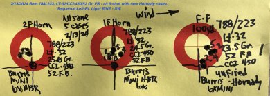

Pretty decent Feb. conditions this afternoon, so, between pointing bullets, and "lubing jackets", we worked some testing/tuning into the work day. Sadly, Al's pillar bedding job failed to produce the expected, "MINUS ZERO" 5-shot groups . . . that said, BIG MIKE advised, that, now, even HE could hit a fox with the 788. :p
Following the initial two shots, to avoid confusion/chasing bullet-holes with reticle, I added 3-clicks of elevation - the rest is pretty straight forward . . . I think.;)For reference, the red rings are 3/8" thick & the inner white 1"; the Burris DOT is 3/8". RG
P.S. it's obvious I missed some condition changes . . . :p Just to please Al, I'll try some BenchMark again, and maybe a more powerful scope.
