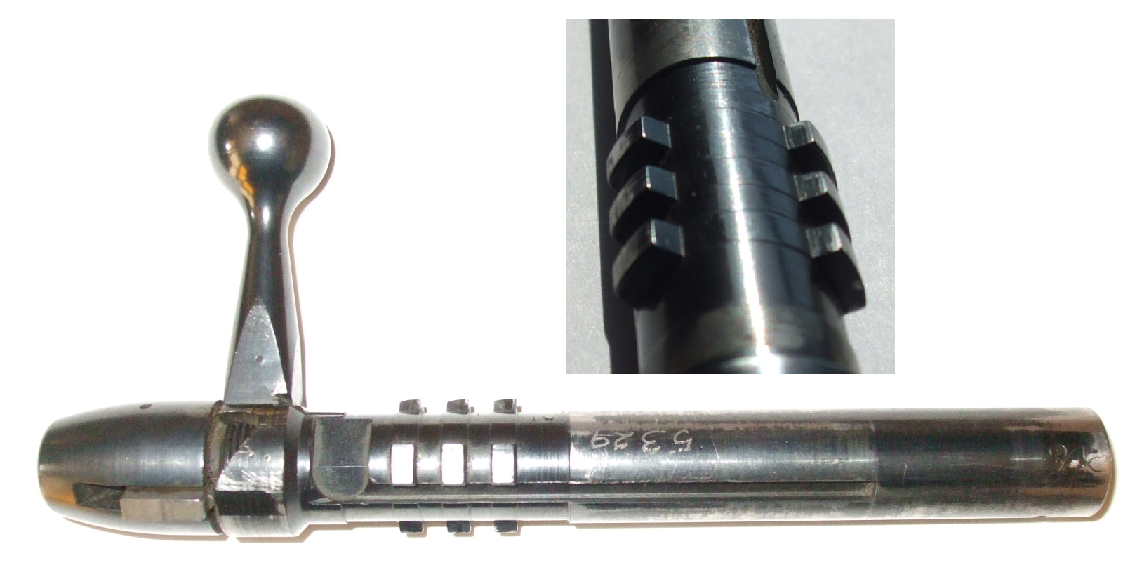

A friend called today and asked if I knew how the bolt handle was attached on a 788, he said his "broke off". Did a search here and found out that they do sometimes come loose but no information regarding how they are attached. I have not seen the rifle in question so I don't know if it actually broke or simply came loose from the bolt sleeve.. Can anyone tell me how they were originally attached?
Thanks in advance.
I bet not. That thing looks VERY different from a 700.
New bolt handles were available at Numrich. Only the ball and shank are part of the handle , not the surrounding piece ( collar ) you see on the bolt body .
I also seem to remember the 788 bolt handle having a bad tendency to take a piece of the bolt sleeve with it when it breaks off. Check both. If the bolt sleeve is missing a chunk it's trash.

Thanks for the replies. Hope to see the bolt this week and assess what actual is "broken" and suggest a solution to the owner.
