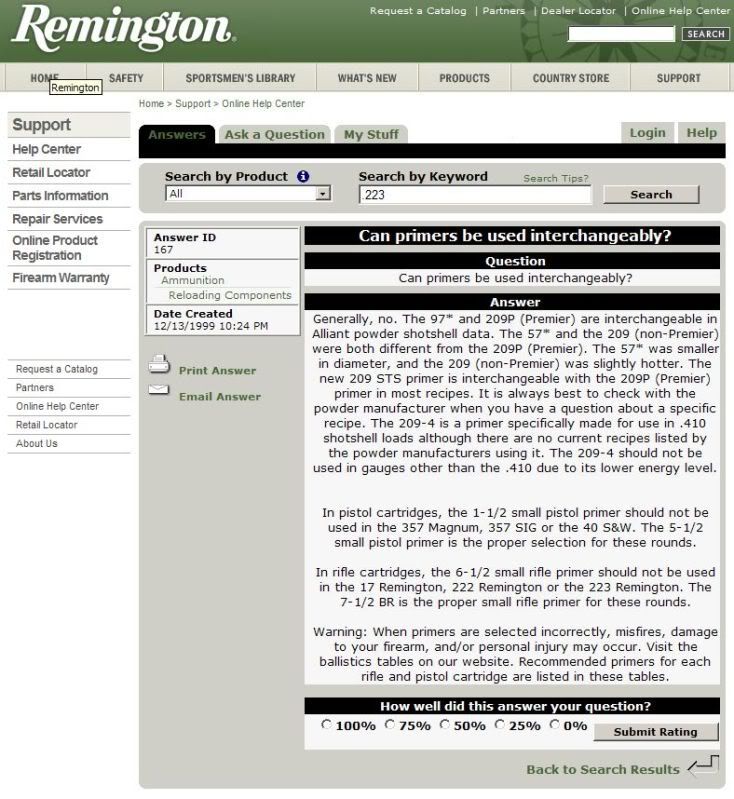

There was a bulletin posted on this web site some time ago that addressed this issue. It stated the following: "Cases that utilize small rifle primers and operate at moderate pressures (40,000 psi) can use CCI 400, Federal 200, Rem 6 1/2, or Win SR. Such cases included 22 CCM, 22 Hornet and the 218 Bee. Other cases that use the small rifle primer can use the above primers only if moderate loads are used. Keep to the lower end of the reloading recommendations. Cases the utilize small rifle primers and operate at higher pressures (55,000 psi) should use CCI 450, CCI BR4, Federal 205 and Rem 7 1/2."
The 6 1/2 primer cup is only .020 and is designed for lower pressure cartridges. You are also warned to never use them in firearms with free floating firing pins due to possibility of slam fires.
The following is posted at the Midwayusa website.
Warning:
Remington does not recommend this primer for use in the 17 Remington, 222 Remington, 223 Remington, 204 Ruger, 17 Remington Fireball. Use the 7-1/2 Small Rifle Bench Rest primer in these cartridges.
This 6-1/2 Small Rifle primer is primarily designed for use in the 22 Hornet.
