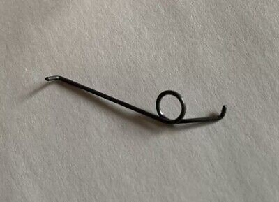

Have an early std barrel rimfire and stupid me drove trigger pins too far and that tiny spring for bolt release launched into who knows where. Searched for an hr with magnet to no avail. Anyone have spares? Thanks in advance
Mine has the small spring that fits in hole in rec, very small
If you let me know the dimensions I should be able to make you a spring
O.D. and Length, an idea of spring pressure
I make coil springs for triggers down to approx .125 OD x .200 L
However, a quick fix might be one of these two things to fit
1. Remove the spring from a Bic lighter - cut it to length with a dremel diamond wheel
2. Remove Tire Valve core from Stem - Cut tip off and remove the spring - cut to length
