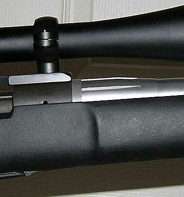

Hi All,
This was a project kept under wraps for quite some time until now. I've only told Paul about this project. Well, finally got my Remington 700PSS back from Pac-Nor. It's a switch barrel set-up with 6BR Norma,.094 freebore) and 308Win,Sniper chamber). The barrel nut uses the Savage wrench. Pac-Nor did a very nice job on the nut -- it's very slick with a nice contour and tight tolerance,check out the attachment). Haven't had a chance to go to the range as it's been raining here in southern Cal. I'll keep ya'll posted.
-John

John,
Now that is just way cool. So this means you can rebarrel a Remington 700 as easy as a Savage. Smart, very smart. So what's the deal--you get a pre-fit from Pac-Nor and just bolt it on? Do they make/sell the barrel nut too?
This could be a mini-revolution for all those tactical guys. Even if you stay in the same caliber, you could have a 30" Palma taper for F-Class TR, and a fat 22" tube for field carry.
Very nice concept and well-executed. Tell us how it shoots as soon as the skies clear! :thumb:
