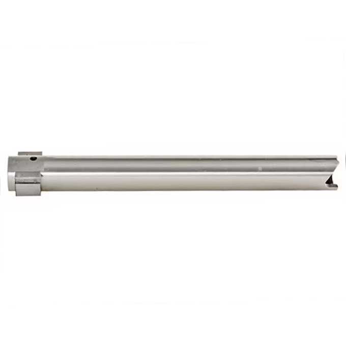

I see the carbon fiber and one piece blueprinted bolts on the PTG site, but not a 2 piece bolt.
Perhaps I'm not looking in the correct place?

You used to be able to. When you ordered one in the past you put diameter notes in when you placed the order. I don't see that option anymore. Since they state they are all custom order and not stocked I wonder if they'll still make them to diameter? The description though shows them as .699". "RH 0.699" OD".
@LVLAaron I was checking the verbiage on the one piece bolts and they state they come .700" default when ordered online but if you want a different OD it says to call to order. I'll bet you could do that with the two piece as well.
