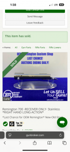

I bought the action thinking it was stainless. That’s what the gun Broker listing that I bought said. someone told me a magnet would not stick to it if it was stainless. A magnet did stick to this action, so I’m assumimg it’s not stainless.

It’s a stainless action. Flip it over and look at the underside of the tang behind the rear action screw, there will be a groove machined perpendicular to the bore axis. All stainless Remington actions have it (and not all stainless actions start with an “S” prefix.) It’s visible in OP’s first picture.

Agreed. It's just a polished stainless rather than brushed.
