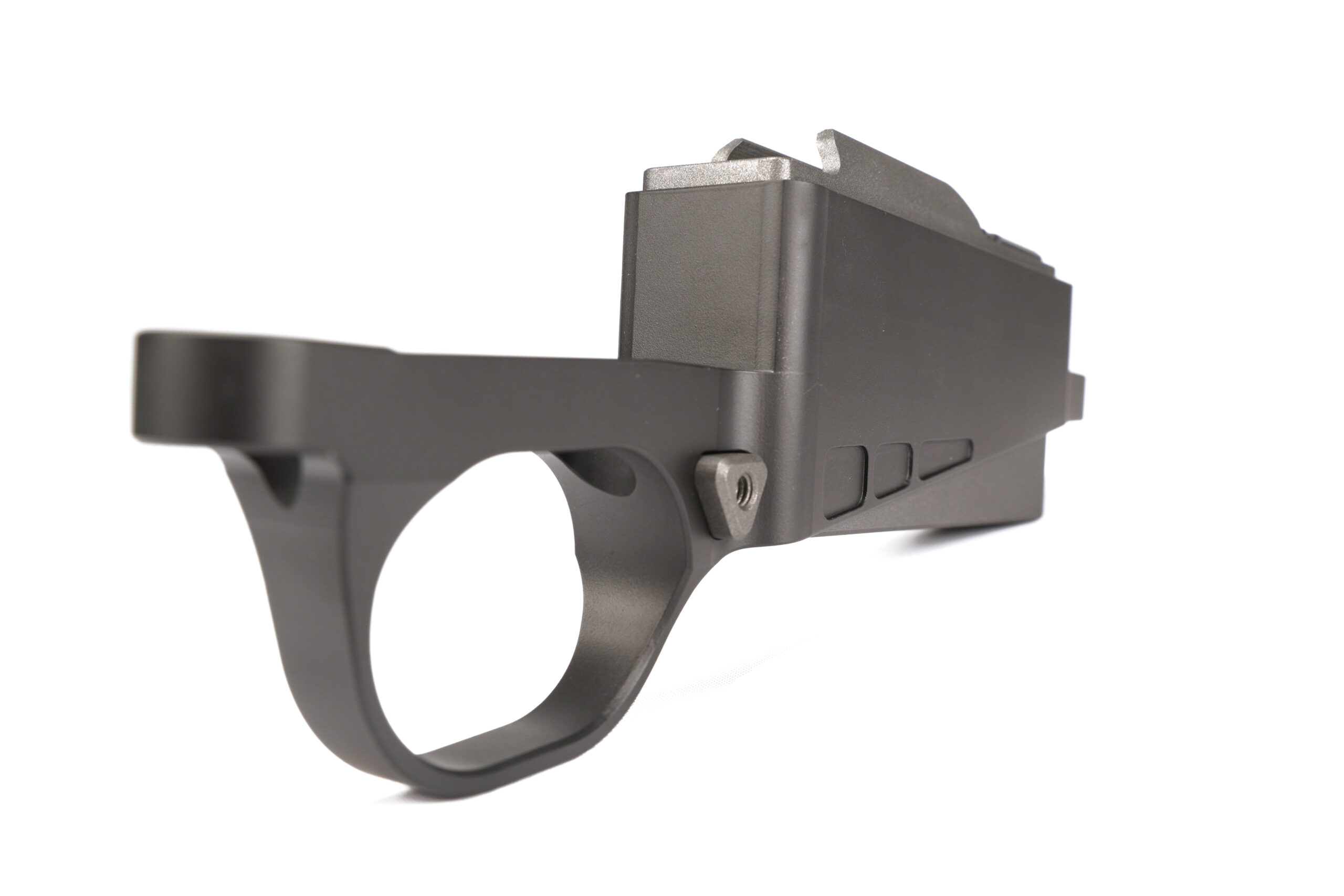

There’s lots of them out there to choose from. Unknown Munitions might have the cleanest looking one for a LA. Hawkins has a nice magazine and bottom metal for a LA too.

The KRG Bravo is an option for something lighter weight, inexpensive, has a DBM and is an easy bolt in and go.

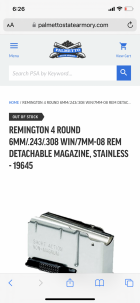

This is a factory removable mag set up just as an option. I put one in a short action a while back and liked it. Four rounds and flush fit. I would consider buying an after market stock and put the factory one in the safe. Good luck. E
