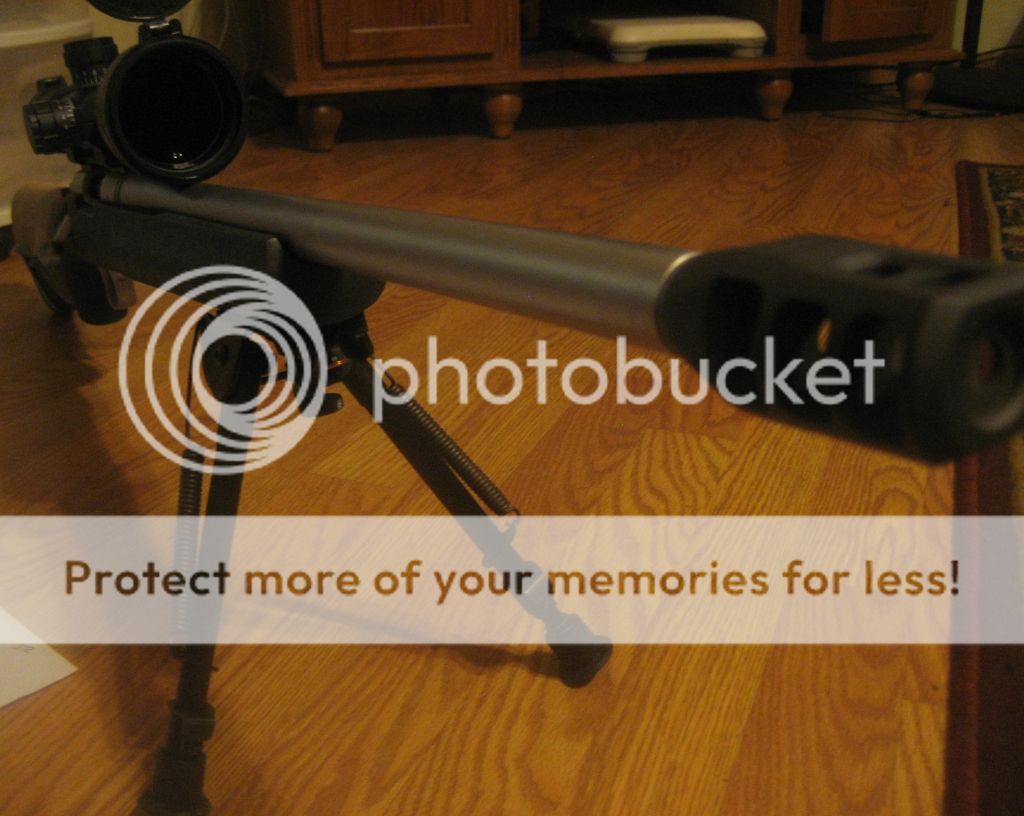

And this is how she sits with the new Precision Armament M11 Brake, and the lil 20"er feels like my 243 shooting 58gr Vmax's
