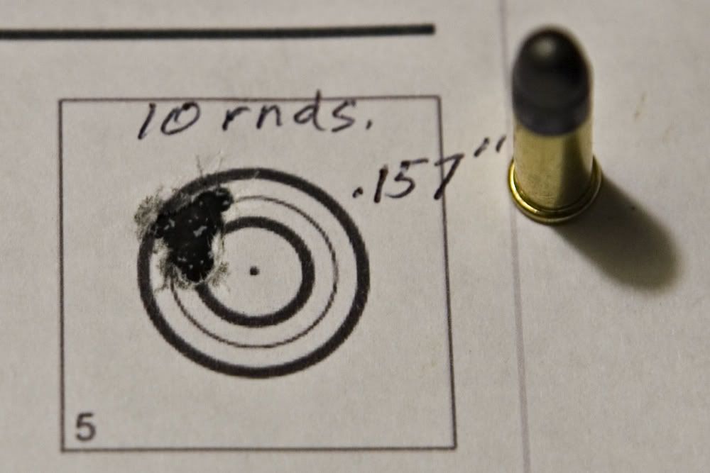

Now that out of the way I would say the 40X, I have only shot mine a little over a month now. But I am already shooting it better than I did the Super Match 54 I sold 15 years ago, and doing it with the same lot of Eley BR GOLD I kept when I sold the Annie. I will say I can reproduce this with perfect conditions, I am not a great condition reader, and I have proven that shooting this rifle in calm cloudy and cool conditions. But my on breezy sunny warm days this seems to afect my results, now I am better than a lot at reading conditions and controling my shots, but get my but kiked regularly by guy's that do it better.
With that said here is what the gun is capable of. all at 50 yards. and perfect conditions with very expensive ammo. first one is 10 shots at I have repeated this 10 shot performance a few times, the rim on the unfired cartridge mic's .270"
