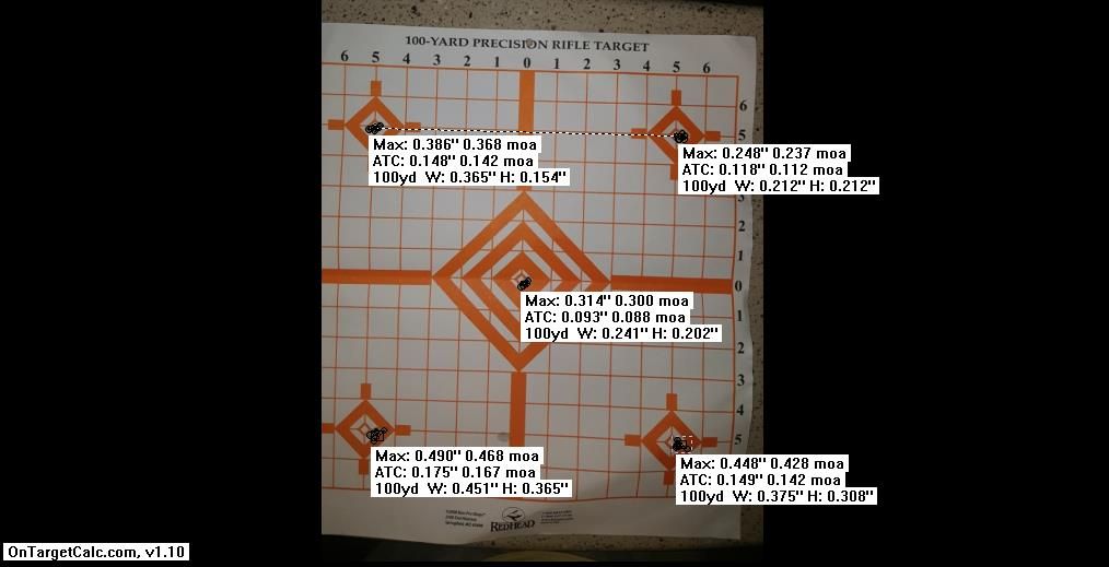

Robert Whitley 6mm AR TURBO 40
fireformed lapua grendel brass, br4, lapua 105 scenar L jammed 0.010, 28.2 gr H4895, 2840 fps.

this is a.home built .223 wild. just never could get it where i wanted it to be. quit messing with ARs. too hard on brass and it is so much easier to get the accuracy out of a bolt gun
Frig man!!!! Those are some awesome groups. Heck with he brass! I'd shoot that baby with all the Lapua I could muster. Can't really ask for more than that. SImply awesome!!!!!!!!!!!!!!!!!!!!
