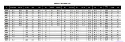

Can anyone tell me what size bushing to use in my Lee Load All II for Winchester Super Handicap powder. The powder can says 20.9 gr. I am loading Remington 12 GA STS hulls, 2 3/4” with 209 primer and CB1118-12 wad with 1 1/8 oz #8 & #9.

19.2 gr powder bushing looks at a better/safer pressure, to me. (PRESSURE changes with different primers.)
Change primer, changes pressure.
Double check all data. USE at your own risk.

I should have mentioned that I am using Ched primers
