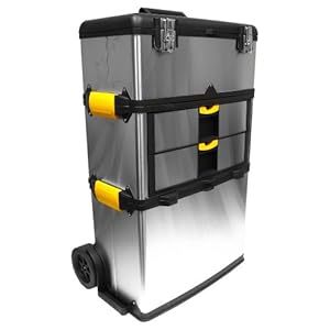

http://ecx.images-amazon.com/images/I/41gRFwdIPfL._SL500_AA300_.jpg
This is what I use for my reloading equipment and supplies. The stack comes apart and travels real nice.
