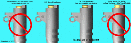

A couple of things to look out for:
1. Do the plunk test. take your barrel out of the pistol and check the fit of a loaded round in it (ref attached image)
2. Overcrimping can cause feed issues as well. 45acp headspaces on the case mouth. You want a diameter of .470 there or the round won't chamber correctly (will definitely show up in the plunk test). Taper crimp enough to just remove the belling at the case mouth.

while technically correct, the truth of the matter is that most( not all) semi autos hold the case by the extractor, long before the case mouth hits the end of the chamber.
you can load to avoid this, tho it is not a big deal at all.
1911's are easy to check....prime a sized case that is at saami spec long side, chamber it.. and pull the trigger. if it goes bang great( it probably will) ; now trim a case very short by 90 thou or so. this should put the case in front of the firing pin. now chamber it and pull the trigger. if it went off..it was the extractor holding it back( or one really long fp).
again technically correct , bu tin real life it seldom happens.
stool; I agree with what you said about the extractor holding the case, limiting it's forward travel in the chamber.
In most instances it is impossible for the case mouth to contact the front of the chamber, since the max. case length is .898", ( but in truth the majorty measure .894" to as short as .888"), while the chambers can be as long as .915".
To check what I say, remove the barrel on any 1911, be sure the chamber is clean, and take a depth measurement from the rear edge of the barrel hood, forward into the chamber, until the depth gauge stops at the front of the chamber. Then compare that length with the case length's of any make 45 ACP brass. A big difference between brass length and chamber length, with brass length always being the shorter.
lol in 20 yrs i have only once seen 45 acp brass that was at sammi spec..all has been shorter.
