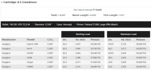

Well, trying to find really the right data for the sierra and lapua bullets. Also using Hornady 140gn and have the app info .and book!
Thought I would find this on the Lapua and Sierra web sites or Hodgdon site..using H4350
Powder weights, and bullet seating...
Hornady ELDM 140....using 40.5gn H4350 and COAL of 2.800
Sierra Match King HP 140 gn ...?? H4350 and COAL ??
Lapua Scenar 139 gn ... ?? H4350 and COAL ??
