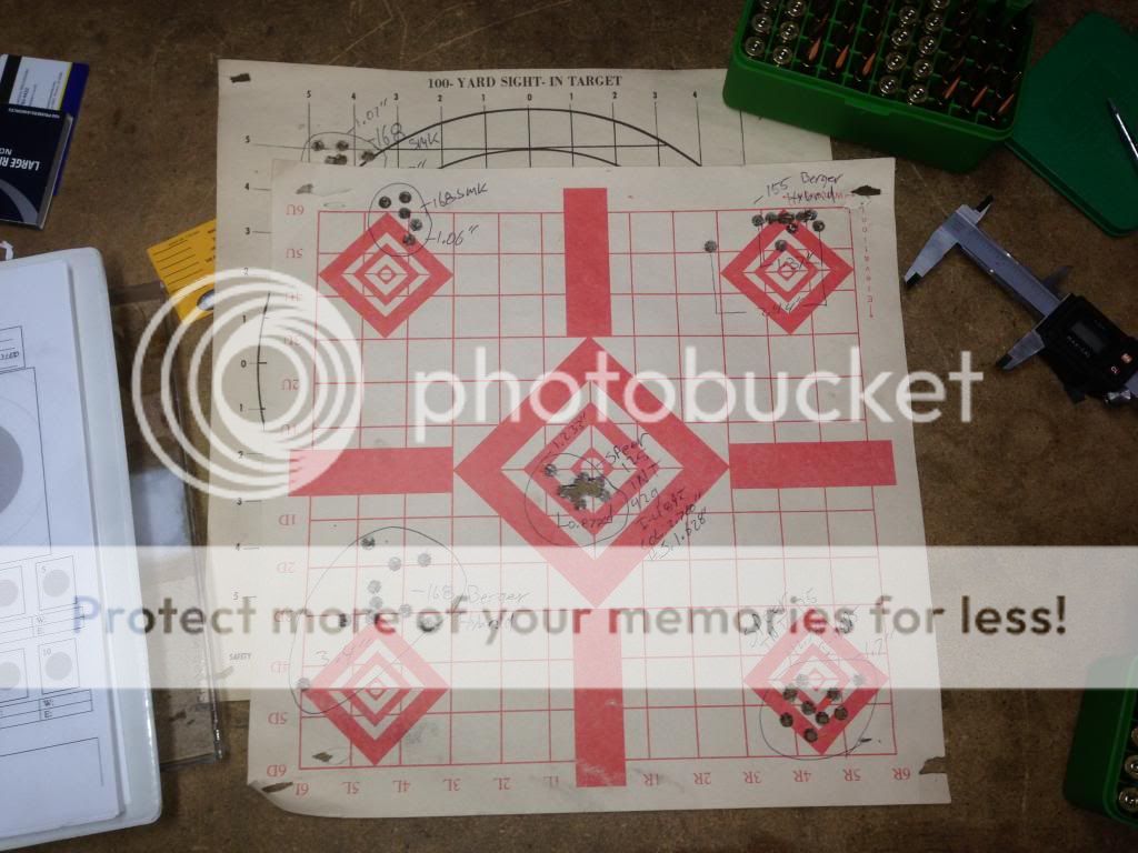

My rifle was shooting great with iron sights so this was the first time shooting it with a scope. Here's a pic of my groups at 100. One of my groups had some wicked horizontal stringing. The center group was my best and it was 10 rounds...
Any advice is appreciated. The rifle is a LRB M14 with a Bassett scope mount and a Zeiss Conquest 3-9x50 with Rapid-Z 600 reticle. I made a hasty cheek rest with some rags taped to the stock until I can get a Kydex cheek rest. I was shooting off Caldwell bags placed just in front of the magazine.

I'm thinking that the horizontal stringing on the 155 Berger group had to do with the way I shot with a scope that day, but I'll know more next trip.
I'll see what happens on my next range trip and get back to you guys. Again, I'm not an experienced scope shooter and I've got a lot to learn. Thanks for helping me out.
